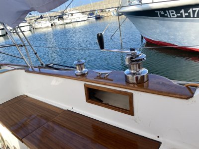

Wow. Now they look brilliant. So what did you do in the end. is this just sanding the existing cockpit seats, or did you replace the wood. whichever I bet your pleased. I used to pour varnish on mine. each time I left the boat. hard as nails.
Steveeasy
oh and new winches and matching cleats. Nice.
New solid seats. I paid a man to make them as it's above my skillset. They were fitted unfinished and I did the finishing. V happy but of course not the budget option!
