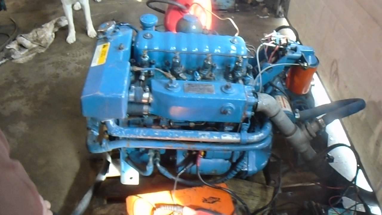

I am going by what two mechanics at the Perkins Agency in Perth told me.( IT IS ONLY THE MARINISING THAT DIFFERS) I have no doubt they are correct. Have a look at these photos (Click the link below) and let me know what you think! :) (Mine has the heat exchanger across the front of the motor)
Perkins 4.108 Marine diesel - Google Search
