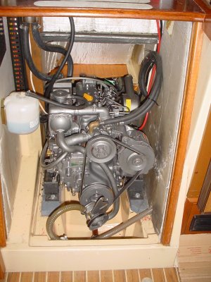

Excellent stuff. I lined the engine compartment of my motorsailer with it. The engine was a BMC 2.2 diesel, a notoriously noisy engine. We were amazed at its effectiveness. I also have it in my Sadler 34, done many years ago (18?) with similar results.DSC00656.JPG. Slight damage to the cloth covering done when removing the alternator but otherwise still looking good.
