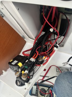

The charger on our boat was suspect (making funny noises, clicking on & off) so I’ve bought a new one to replace it.
My plan at the moment is to only leave the domestic battery plugged in on the charger long term.
My thought process is that a good battery with nothing discharging it should last for years with only alternator charging.
If I permanently leave the engine battery charging then the boat will always start BUT after say a night away from the marina with no shore power or even a day with a couple of different stops, then it might not start if the battery is getting suspect. And all that leaving it permanently charging will do is mask a weak battery.
Am I over thinking it?
What’s the usual way of doing things?
Cheers!

More common to have the engine battery on charge, lead acid batteries like to be kept charge. A battery can fail at any time, however it's charged, so have an alternate way of starting the engine. What boat do you have and what isolator switches.
It’s a Merry Fisher 755 with a Suzuki outboard. I have a lithium jump pack kept on the boat just in case.
The isolators are a switch for common negative then 1 for engine & 1 for domestic.
I’d happily put another charger in for the engine battery if that’s the best way to do things. The other option would be to use the split charge VSR to do the job (once I’ve worked out how it’s wired).
Charge the domestics but have a combining switch so that if your engine battery weakens you can connect both and start
I had thought about this. Or just carry a short jump lead.

The jump pack should get you out of trouble. You can also take all of the connections off of the negative switch and join them together with a terminal post, then connect a cable from the load side of the engine switch to the black switch and another from the load side of the domestic switch to the other terminal on the black switch. Paint the black switch or wrap it in tape, yellow is a good colour choice, put a label on it "emergency only".
If you have a VSR it should be charging both batteries, not matter what charging source you are using. But double check, in case its an older, single sense VSR. You can check using a multimeter, measure the voltage at each battery with no charging on, the switch the shore charger on and measure the voltages again, if the both rise the charger is charging both batteries, do the same check with the engine running and the charger off.
Had to read this a couple of times but I think you essentially mean permanently connect all the negative cables together as there's no need for them to be isolated and use the now redundant switch as the emergency? Possibly something for the future as I'd like to sort this mess out a bit at some point.
There's no fuses (that I've found yet) between the batteries and these isolators on a cable run of 2m+, so I think that's the first job.
I did a bit of testing. Yes it charges both batteries when the domestic is being charged but only with the isolators switched on so it must be wired to the load side of the isolators. With the engine isolator off the batteries don't get combined.

I've just added a Victron charger but I just went single as at some point I'll likely swap the domestic battery to Lithium so the dual output wouldn't work with mixed chemistries.
(I'll have to change the "dumb" VSR too).
Yes, exactly what i meant.
Yes, fusing would be good.
It charges as expected with the engine running.
I'd move it to the battery side of the isolators.
