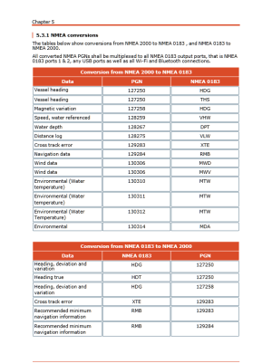

11 Dec 2025 #1 PaulRainbow Well-Known Member Joined 16 May 2016 Messages 19,456 Location Suffolk Visit site There has been a few discussions about the multiplexing capabilities of the B900 series Em-trak AIS transceivers, the table below shows the full details.
11 Dec 2025 #2 mrming Well-Known Member Joined 28 Jul 2012 Messages 1,844 Location immaculateyachts on Instagram instagram.com Is the feature live now @PaulRainbow? Last time I checked it hadn’t been released (which admittedly was some time ago). I’ll do an update if so!
11 Dec 2025 #3 PaulRainbow Well-Known Member Joined 16 May 2016 Messages 19,456 Location Suffolk Visit site mrming said: Is the feature live now @PaulRainbow? Last time I checked it hadn’t been released (which admittedly was some time ago). I’ll do an update if so! Click to expand... Yes, the above table is from the current manual.
