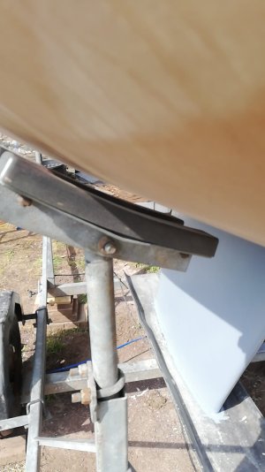

A bit of an update on this - I decided to go the "take it all off and start again" route - and am (mostly) glad I did.
The layers of crud on the keel literally fell away as soon as I touched them, revealing mostly intact epoxy primer on the steel. The rusty looking boundary between keel and bottom is fairing compound being blown out of the gap - I have dug this out without too much bother.
The hull on the other hand is proving a sod to get clean (3 afternoons so far, and just over 1/3 done), the black layer between the normal AF and the (now proven to be) epoxy is an absolute swine to get off - I'm thinking it might be one of the vinyl type primers. I couldn't bear the noise of the tungsten scraper, so am using an electric one, which does a good but slow job. Then doing the last bits with 80 grit on a random orbiter.
When clean the epoxy is very fair, with some tiny osmosis blisters (nothing worth worrying about). It's so good in fact that I'm incredibly tempted to go down the Coppercoat route - I really don't want to be under there again next year, and the cost is only about double of regular AF (yes, I have a live quote). The boat's a keeper, so it seems to make sense.

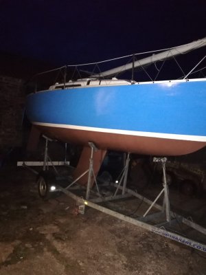

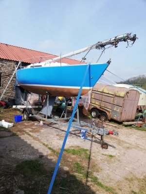

Final update on this thread - I went the whole nine yards.
I Deeply regret the amount of time it took to get the hull clean, and the keel clean enough to prime and fair, but by the time I'd done it the coppercoat was a no-brainer. Then it was a matter of waiting for a window in the weather, which we finally had this weekend.
Really chuffed that I could balance the boat on straps so I could drop the trailer legs out of the way to paint straight through (apart from under the keel of course).
Incredibly hard work on my own, even on a small boat - once you start you can't stop, and it's heavy stuff to work.
Anyway, here she is in all her brownness when I finished last night.
