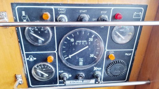

A friend is in between Labrador and Greenland. Inconvenient electrical problem.
Charging light staying on, occasionally, when electrics switched off at engine control panel and sometime glows slightly when engine running. Occasional buzzing behind panel when electrics switched off at panel.
All stops when main battery switch put to off. Batteries charge fine. Can start and stop engine fine at present and can do without panel i believe.
Engine is Perkins M65. Control panel is by Sabre, bought by Perkins, Perkins can't help.
I need to take parts to fix this next week. I would very much appreciate others thinking this through as well.

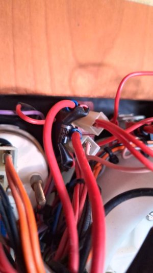

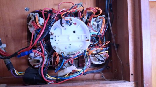

Seems to me it is most probably the on/off/stop switch that is at fault. Yet when you look behind the panel the switch is doing a lot of work. Can't make out if it is a single pole(3 lugs) or double pole (6 lugs). See close up picture. Is that a resistor in there? starts to be above my pay grade at that point.

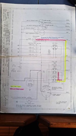

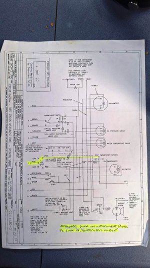

Wiring diagram shows a resistor by passing warning lamp. Could it be that? Not a hundred percent sure wiring diagram is 100% accurate.

I am sorry but really can't help, any thoughts would be pure guesswork and speculation. It really needs on site investigation. That black device with the silver band in the middle picture looks like a diode, not a resistor. Don't dive in and rip everything apart. Try one thing at a time, see if anything makes a difference. There are two diodes for the oil and water alarms at the top of one of the drawings. Just possible there could be a fault there, maybe! try those first, disconnect each in turn. If you are going to be fault finding for any time make sure you can recharge the batteries.
sorry can't be more helpful. Let us know how it goes, May not do any harm to take a new switch anyway. Shame you cannot ID the diodes. But a couple of spares of almost any size above an amp or so may be an idea.

If it is a resistor across the ignition warning lamp, it is to increase the exciter current on the alternator, its not your problem.
Your oil pressure and water temperature warning lights/alarm are probably controlled by diode logic to stop them affecting one another. I cannot read your circuit diagrams as the definition is too poor. Check those diodes, 1N4001 or any last number up to 7 will be suitable.
