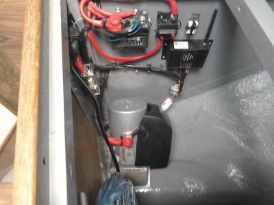

That is similar to the type I used. You can see it above the wireless transmitter. Lofrans control box to the left
