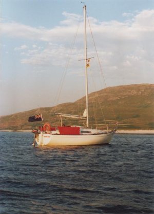

I had a 5HP outboard on my first Sadler 25 and it was adequate for motoring in benign conditions, but any amount of wind/sea I had to sail! It was mounted on a transom bracket offset to port.
