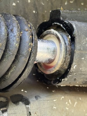

Sorry all - completely my fault in creating the confusion here…. And I can’t seem to edit the original post!!
I am talking about Steering Rams.
So ignore any reference to trim ram.
Here’s the offending item; I’ve ordered replacements (I’ll do both).
Q: Any tips on preventing fluid leakage from hoses once detached? And any tips to aid filling the new rams and bleeding them?

Be very careful not to cross the threads when fitting the hose ends into the new rams.
Sail Tape over the hose ends prevents major leakage.
I removed bubbles by moving the steering side to side lots of times and topping up at the steering wheel with the engines running.
There might be a more professional way of doing that.
