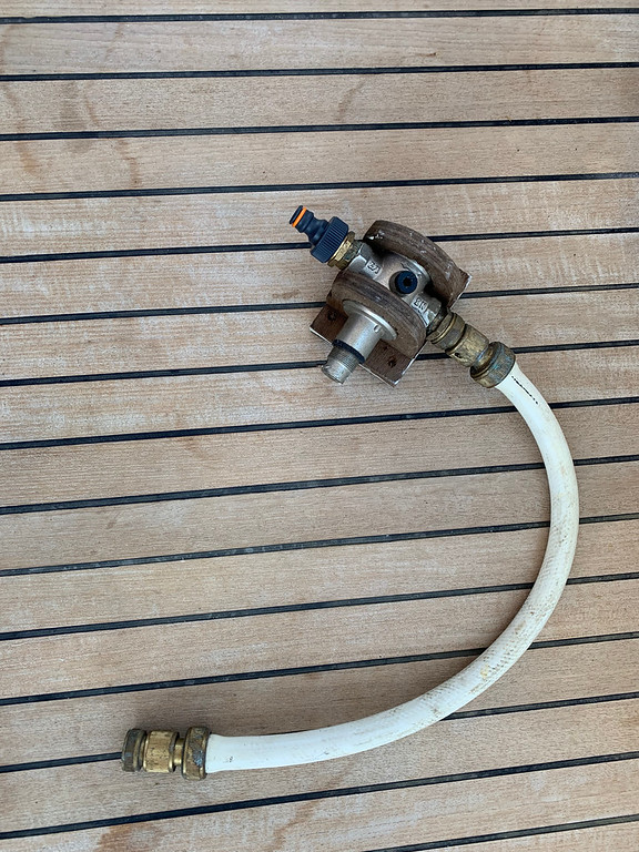

2) If you share the concern mentioned by petem (not that you have to, since you have a properly built IT boat :rolleyes:), you can fit one of these self-locking valves.

I did take a look at those blockers last year but suspected that showers on our boat would regularly exceed 50 litres. I looked for a larger one but had no luck. I suppose I could parallel a couple, but didn't give it much more thought.
