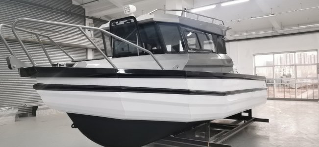

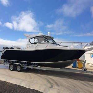

Hello there. I am Nova. I want to know which fish material is more popular. Can u give me an advice?​
When it comes to fishing boats, more and more people are choosing aluminum these days. It’s lighter, easier to maintain, more fuel-efficient, and has a longer lifespan. Fiberglass boats, on the other hand, have smoother and more attractive lines, produce less noise, but are heavier, consume more fuel, and have higher maintenance costs. Overall, everyone has their own preference. If you were to buy a fishing boat, which material would you prefer?
