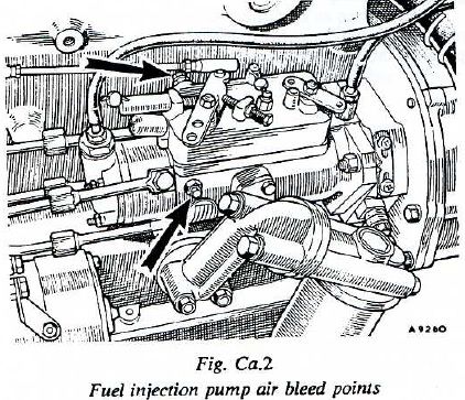

well diesels are quite simple to work with. check fuel is flowing from Tank. then check its flowing from filter housing. then check its coming out lift pump when pumped . then loosen a bleed screw on injector pump and pump lift pump till diesel comes out.. then loosen an injector and try and start the engine. if she starts just tighten injector. A tap with a hard object on injector pump can help with stuck valves.
