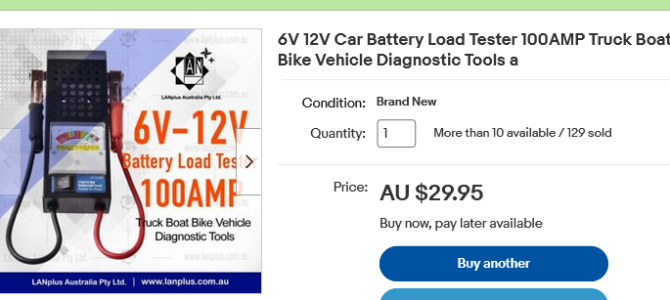

I bought one of these Battery Load Testers the other day as I thought I had destroyed a battery. (happily I hadn't):D
My Son (HD Diesel Fitter) says it is an el Cheapo. Would you have any misgivings using it in a situation like mine?
Screenshot 2023-04-30 at 12-05-33 6V 12V Car Battery Load Tester 100AMP Truck Boat Bike Vehicl...png
