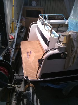

I need to replace the synthetic teak on my cockpit seats and floor. The previous owner had laid synthetic teak strips but had not made a good job of gluing them together. Water gets underneath the strips and is squirted out when you sit down - most unpleasant! I am a cheapskate so don't want to pay for custom made panels. Has anyone had any experience in making up their own panels who can give me some pointers on ease of installation and suppliers
If you search Hurricane’s posts on the motorboat forum, you will find an excellent thread for DIY installation.
TEK DEK / Trak Mark have a DIY product range, or you can purchase their professional fit range for DIY fit
Tek-Dek - Synthetic Teak Decking
I completed my project with their prof range
