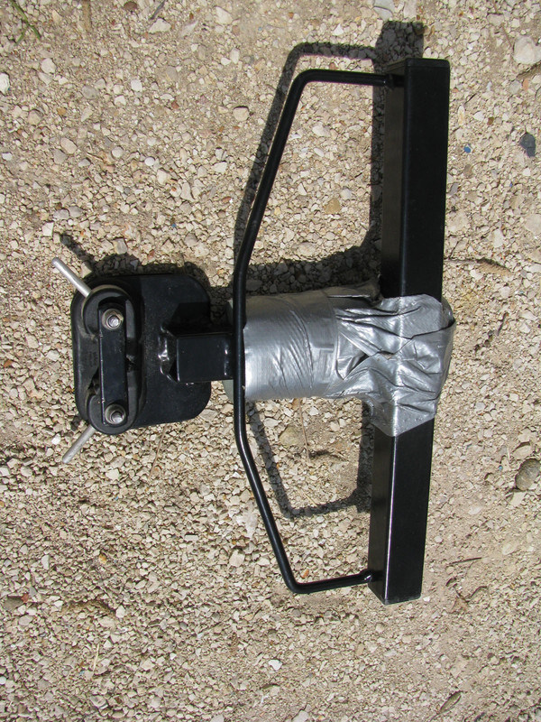

I made this one a few years back. Webbing, sail sliders and aluminium right angle.
