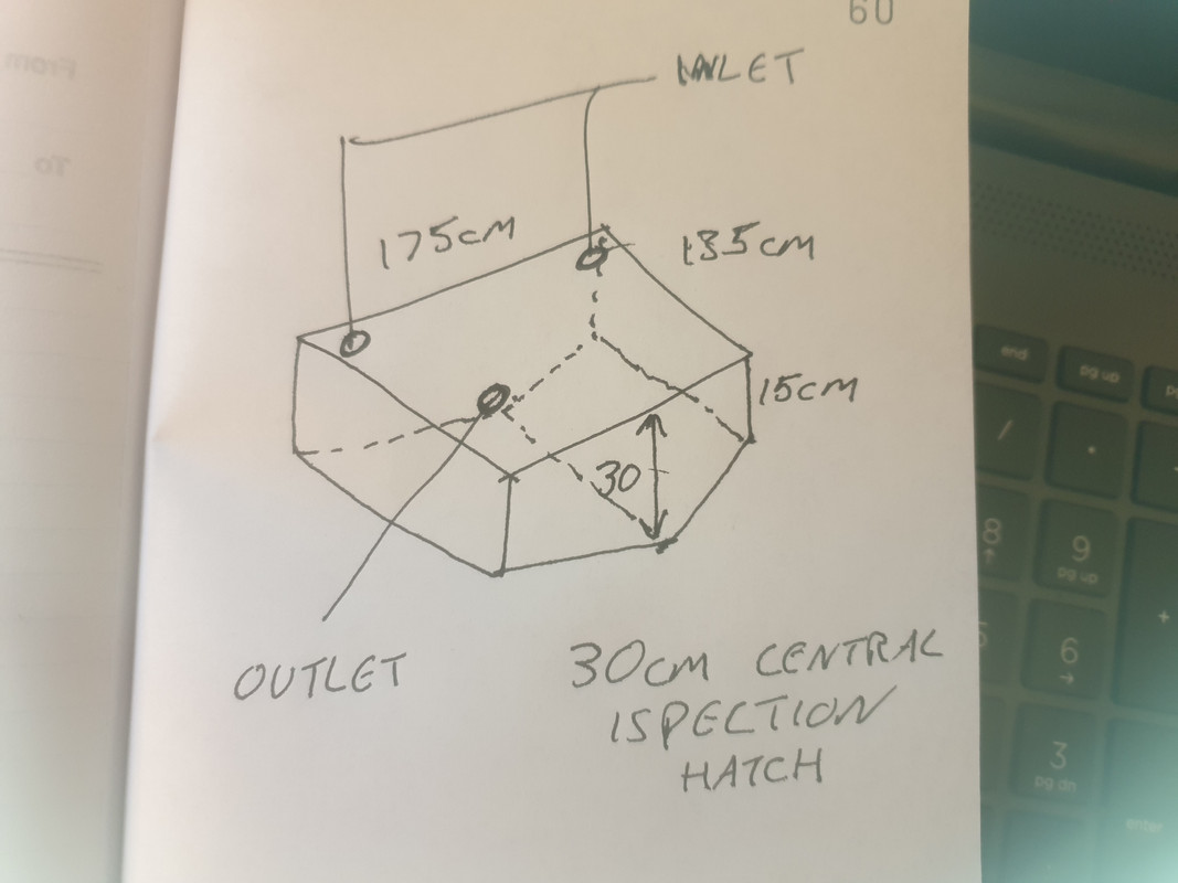

I want it big as possible, this is not that large to a lot of live aboards on the canals. Bigger the better, just for less top ups.
Oh yes it will be a properly built tank even though it would be a DIY tank, baffled and braced etc.
I have been looking at prices of HDPE sheets and rough cost will be £300-£350 for a slight smaller tank of 175cm x 100cm. When i was looking the other day i priced it up at over £600 for materials. they were 2m x 1m sheets though . One way i can do it is have this one under the centre deck and another flexi tank in the bow of 100 liters as back up.
I can use the ready made tanks but i want to save and use as much space as possible and the set out doesnt allow for these size/shape tanks.
