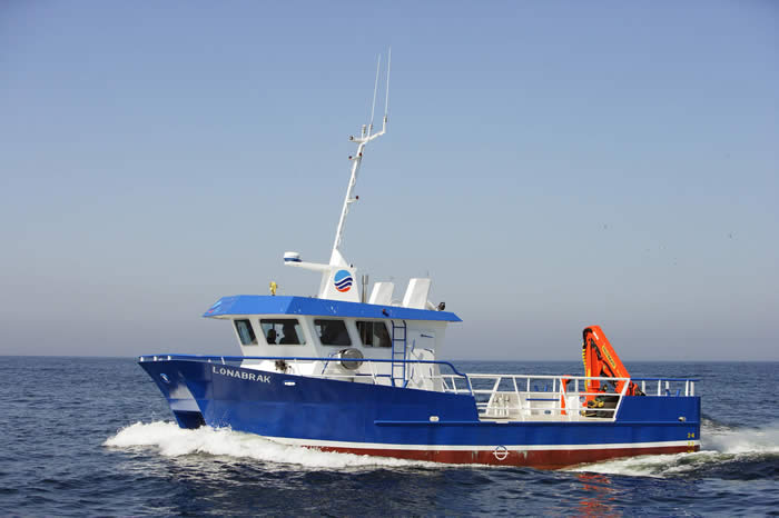

The alloy cat in my avatar has very narrow displacement hulls with a length / beam ratio of 15 at the waterline - she is very directionally stable, to the extent that she will happily proceed in a straight line under one engine, despite being 16' wide.
But this also means that she can be a bit twitchy in a following sea as Nautibusiness describes above - if she decides to go down a wave diagonally rather than straight down, applying full helm over is not going to have an awful lot of effect.....
