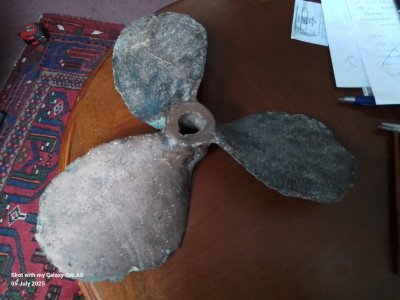

When bits start falling off it ! First you get areas of pink but then it becomes brittle and you can snap chunks off with your fingers...
The prop in the pic has also lost 1.5" of its diameter...

Mine never deformed, just shrunk with 40hp turning it. 15" prop.

Dezincification of brass (not bronze, which contains no significant zinc) occurs from the surface, penetrating inwards. You may well find that the pinkness is a very thin layer that will abrade off. Replacement of the prop is not needed until chunks of predominantly spongy copper are falling off.
Painting the prop is a very effective way of delaying dezincification.

Unlikely that the prop has changed dimensions (pitch) or diameter sufficient to affect performance. As suggested the pink is probably only on the surface. If the blades ring when tapped with a hammer it is not dezincified
