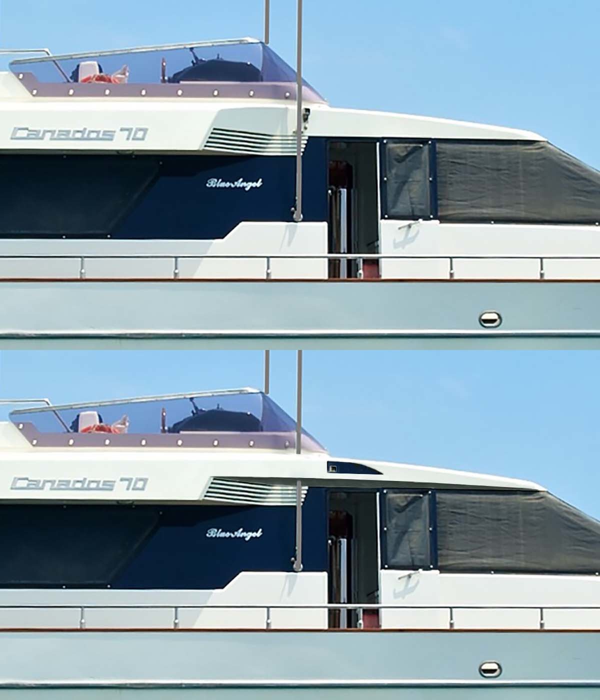

Actually I removed the grille on the current overhang because Canados dismissed it in the more recent C24/C25, and I assumed that you liked that "cleaner" style better.
But I'd expect both alternatives to be feasible for the carpenter, since the overhang extension has to be custom built anyway, so it'll be up to you to pick your poison! :giggle:
Rgardless, I agree that the perspective was a bit wrong in my previous drawing.
Here's another version where I left the grille and adjusted the new overhang.
By this rate, you might as well re-touch all the BA pics that you have onboard, and do nothing in flesh! :ROFLMAO:
yes thats it P, including the shaded underside of the extension, nice !!!
the integrated nav light looks doable ,
lol, two days offline and you've remodelled BA ?
sorry still busy with real work (end of semester/exams etc)
I have to admit that starting to read the thread I didn't quite like the idea, but this last pic by P I really do like, well done P!
I probably wouldn't do such a large recess for the navlights, maybe not at all, maybe half recess half protruding at the rear with a 150-200mm recess on side elevation only.
However, my main objection is in not designing and building a hard/soft top yet, Med sun is getting worse, need to cover :cool:
BTW, Bart, you'll obvs have to do something about the front f/b tent poles, are you going to secure them on top of this extension or what?

P, I'm with Vas on this,
I'm afraid its a bit too much function over form,
with your brilliant photoshop model,
its easy to imagine that without the black recess, it looks a bit more slick (imo)

Hi Vas,
since we have those tents, / sun shades, the problem with med sun is completely cured,
and to be very honest; looking at pictures from newer model with hardtop,
I think that the hardtop on this boat, is no esthetic improvement rather the opposite.
yes, the poles have to be taken care,
for now the option remains to make them as in this draiwng, going THROUGH the new extension,
for solid mounting, this would be the best option,
unless we make a steel frame / pole base inside the new overhang, been there done that for our crane
isn't that a nice enough challange ? :)
