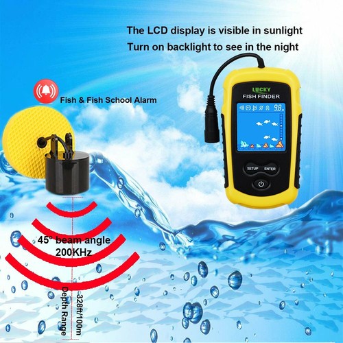

The Fish Finder I have does show shallow water ... shallow enough to save a dagger board ...
Specs say 0.7m to 100m ... but it actually shows less than that on mine ... about 0.5m .....
I had an old Seafarer sounder before it ... but sadly that got lost over time ...
I use mine not only for fishing - but also to monitor my channel depth as it silts up.
The cheap battery powered units all seem to be designed for fishing, not for use on a moving boat. Most seem to have a floating transducer.
Can't seem to find the combination of transom mounted transducer and battery power...

If you look at the picture ... you see two vertical lugs on the transducer - those fit a purpose designed mount that can be screwed or glued to transom. A bolt with thumb screw holds the two together.
The float ring can be removed easily.
Moving or stationary - it works fine as the transducer is basically same as any other - just maybe lower powered.
