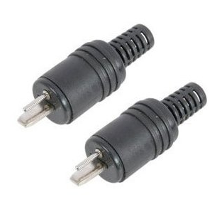

It works off batteries. Should I want to power it from 12 v in: It has a round socket about 10/12mm dia. The central, large, pin is rectangular with a smaller round pin above. Could be a bespoke item, anyone recognise it or even have one of these female plugs going spare?
Can I expect the large pin to be positive? I am not sure how the thing would react to reverse polarity.

That will be a DIN speaker plug
DIN plug Round pin is probably positive but I will have a look in my box of old sounders and see if I can confirm.
Yep - thats it !!
Any home electrical / music shop should have them ....
