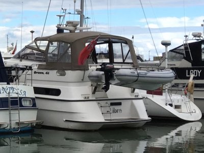

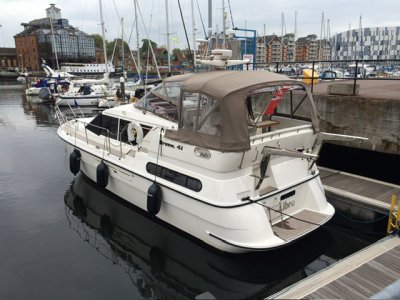

I think I would be looking to install traditional davits on the section below the boat name so that they could be operated whilst kneeling on the bench seat. That was the set up we had on our Broom 41 (similar aft cabin design with a seat across the transom) and it worked well.

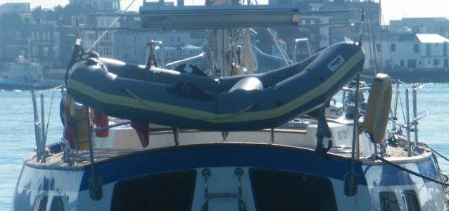

This is what I had (came with the boat), but they did flex a bit, so I additionally secured them to the top of the pushpit rail. I clocked up thousands of miles like this without any issue. The GRP was about 1/2 - 3/4" thickness.
(Sagging dingy due to cold morning temps).

Thanks guys.. Some food for thought. I think with the Broom the elevation of the davits allows you to still mostly access the bathing platform with the dinghy in the davits. If the dinghy was any lower I can't see how you'd access it. For me I'm trying to keep the Dinghy at a reasonable height as my aft deck is pretty high..
I'm thinking I may even sit the dinghy on mounts on the bathing platform when underway to keep the COG low but to use the davits for lifting and when moored etc. I just don't want to be removing the outboard from the dinghy all the time. (9.9hp 2-stroke.. around 27kg. Not heavy but pain to get on and off)

Just trying to see the pic clearly. So the davits bolt through the transom and have a bracket above holding them together?
Obi
23 Jun 2009
654
Landlocked temporarily.
Correct, they are fitted in similar way to the chain plates on this yacht, with a metal plate either side of the GRP. The external plate is welded to the davits and the internal one is secured through the GRP with bolts and sikaflex to the external one.
Where the steel pipes rise up towards the top of the pushpit, there were simply lashed with cord. It did not look as bad as it sounds and the cord allowed me to tune how tightly they were held inboard.

Access to the bathing platform with a RIB on either chocks or davits is usually a bit of a problem on most boats to be honest. We had side access to the Broom (in-hull step and gate in the guardrails) so that is what we usually used. Friends in our marina have an aft cabin boat with no side access and they are in a bit of a conundrum about what do with the RIB.
