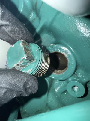

Every other year I replace the coolant in our trusty D2-55A Volvo engine. What winds me up about this process is the drain plug, on the stb side of the engine, that once taken out, then liberally sprays the captain and the stb aft cabin in coolant as it shoots out under pressure (I suppose the pressure isn’t a bad thing, as it’ll pick up any crud with it).
I have seen modifications that drill the center of the drain screw, tap it, and then put something a bit more civilised in, like a bleed screw? Anyone have experience of that modification? Is it a good fix?

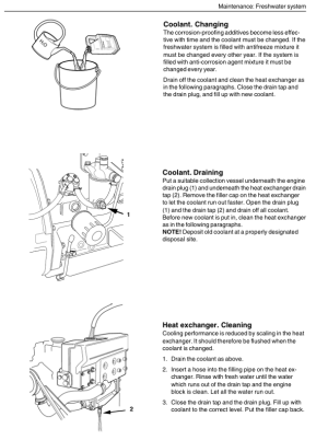

Maybe draining most of the coolant via the heat exchanger draincock ( #2 in the attached diagram) can be done in a more controlled manner. Finally removing the plug from the block to drain the remainder
Is that the drain on the raw water side? If it's not, that would be genius, as it's lower down it would also get more coolant out I bet too.

No its the heat exchanger coolant drain.
Read the section in your owners manual on maintenance of the freshwater system
If you have mislaid your copy download another from Manuals & handbooks | Volvo Penta UK & IE
