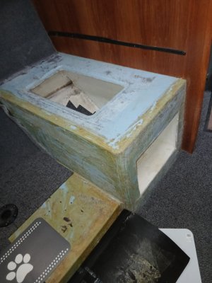

I posted previously on cutting out a grp floor locker ,originally intended for an inflatable.
Cutting Fibreglass
You will see in the last post that the reciprocating chisel blade proved by far the best ,especially for its ability to get into tight corners which you may have to deal with.
Cutting Fibreglass
