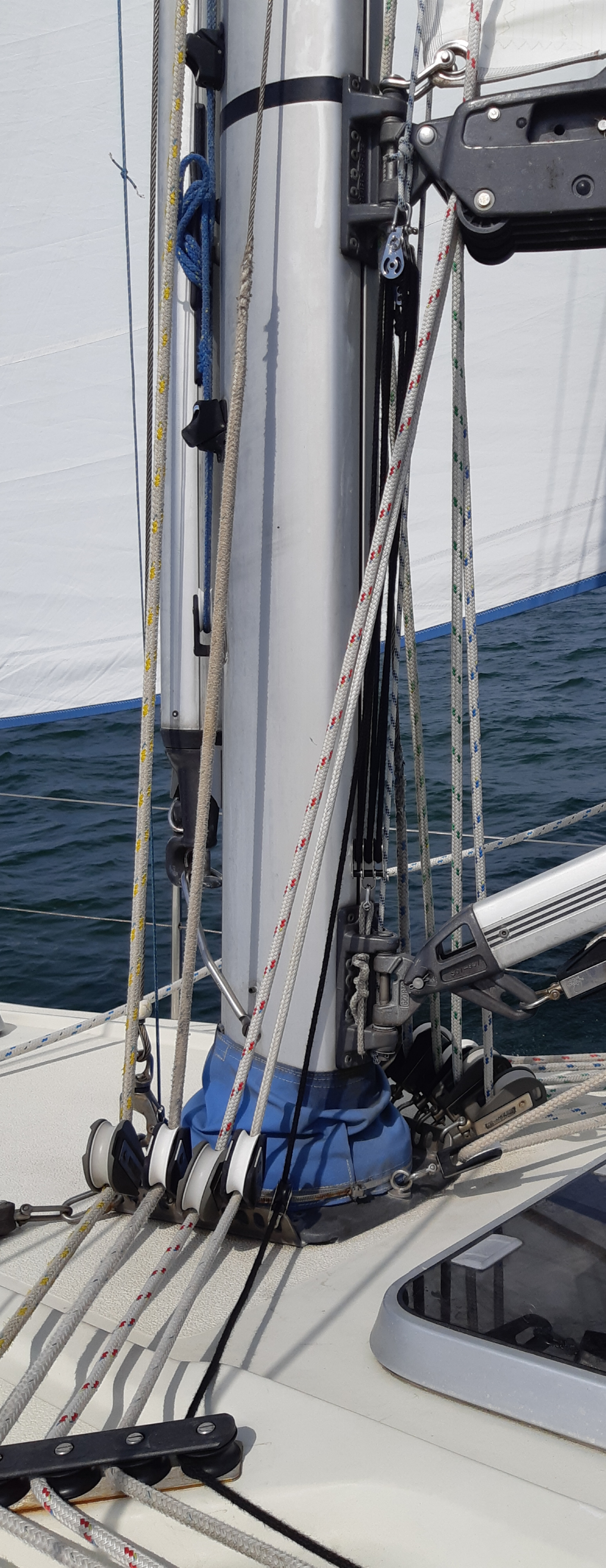

When you have worked out a solution be interested to see a photo as interested in what’s required in a yacht compared to this type of control in a dinghy.
Well I found some dinghy blocks in a box in the garage, last used to haul a train set up to the ceiling in a nine-year-old's bedroom. (Said nine-year-old is just about to turn 30!) Set it up today - on a beam reach with 10 to 12 knots of wind so I didn't really need it. But tightening it has a pronounced effect on sail shape. Cost so far is zero!
Pictures aren't great but the black rope is in a 6:1 tackle anchored on the rod kicker swivel, this pulls down on a short rope from the other side of the kicker swivel after this rope has been up, through the eye in the sail and down again. The working end of the black rope goes through a couple of turning blocks and back to a cam cleat on the cabin top. The cam cleat was used for a boom brake when we bought the boat but we took it off. The small diameter plain bearing blocks aren't great but they will do for now I'll have to see how they stand up to a bit of a blow.

That'll do the job... In general plain blocks are fine for applications like this which are set and leave. Ball bearing blocks are best used for constant trimming applications.
If you're only pulling them by hand then I can't see that you'll ever put too much load on them. But if you're worried you could put a fuse in the system, say by anchoring your 2:1 purchase using a much smaller line.
