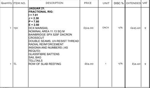

Bear in mind that 2017 is a loooooong time ago in terms of the economy. Materials (probably 2x) and labour (probably 1.5x) are both substantially higher than they were then. I'd say today that would be £700-£1000
I asked for quote on a budget genny - just for cruising .... 1200 euros. Boat 25ft motor sailer ... so sail probably not much more than OP ..
