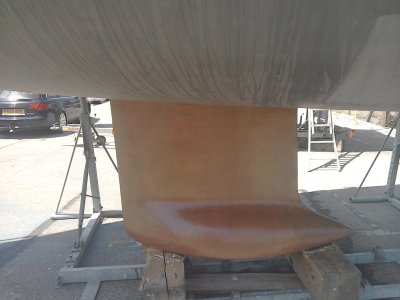

Mine was applied seamlessly over the joint, and when i recoated the iron keel I ran the new coating roughly 20cm into hull. However the Bavaria keel is glued on (as well as bolts!) and there is no discernable flexible joint. Not sure what you mean by sump, but the same principle will apply if it is a joint.
