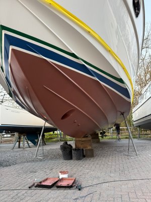

Following this with interest; I recently decided to remove decades of old antifoul from my 25 year old boat and apply Coppercoat - had it done professionally. Costly job but I reckon the breakeven is the fourth season, so as this boat is a keeper (it says here) I'm hoping to be quids in.
Post-application pic for interest.
Happy to recommend the team that did it. PM me if you want details.

Fantastic job.
