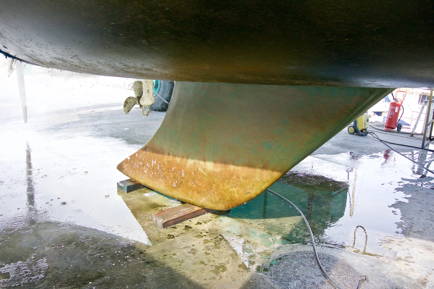

CC'd my boat 4 years ago, here in Corfu.
Killed me, rolling it on by myself. Needs at least 2 or 3 of you.
Applied nearly 5 full coats.
It works really well and very happy with it, providing I use the boat regularly, otherwise lots of slime (nothing else to talk of, though, but slime easily brushed off))
I gently abrade with Wet&Dry P180, every winter.
We'll see how long, before I've worn it out..!

Don’t abrade it! It doesn’t say that in the manual. The internet made that up!!!
You are doing needless work and wearing it out.
