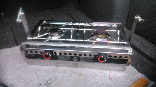

The days of using smelly meths on spirit stoves is long gone. Bioethanol is completely odourless, easy to store and a fire or spills can be dealt with using water. I use Bioethanol Fuel for Fires, Spirit Marine Stove Fuel, Alcohol Camping Fuel and BBQ Lighting Fluid | EkoFuel on our Origo 3k. There’s no dedicated gas locker on our Horizon 23 and I not a fan of cartridges. The Origo has been great.

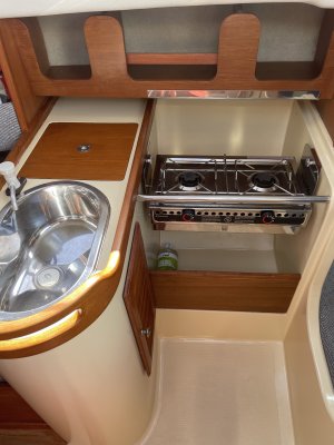

Interesting. Same boat as me. But I swear your Dometic stove looks identical to my Spinflow stove, apart from the name on it.
Practically, it will be the same. I think there are various good clones knocking about these days and I’m sure yours will be just as good as one that says Origo on it. So simple, just a big Trangia. Wouldn’t be without on a boat this size.
