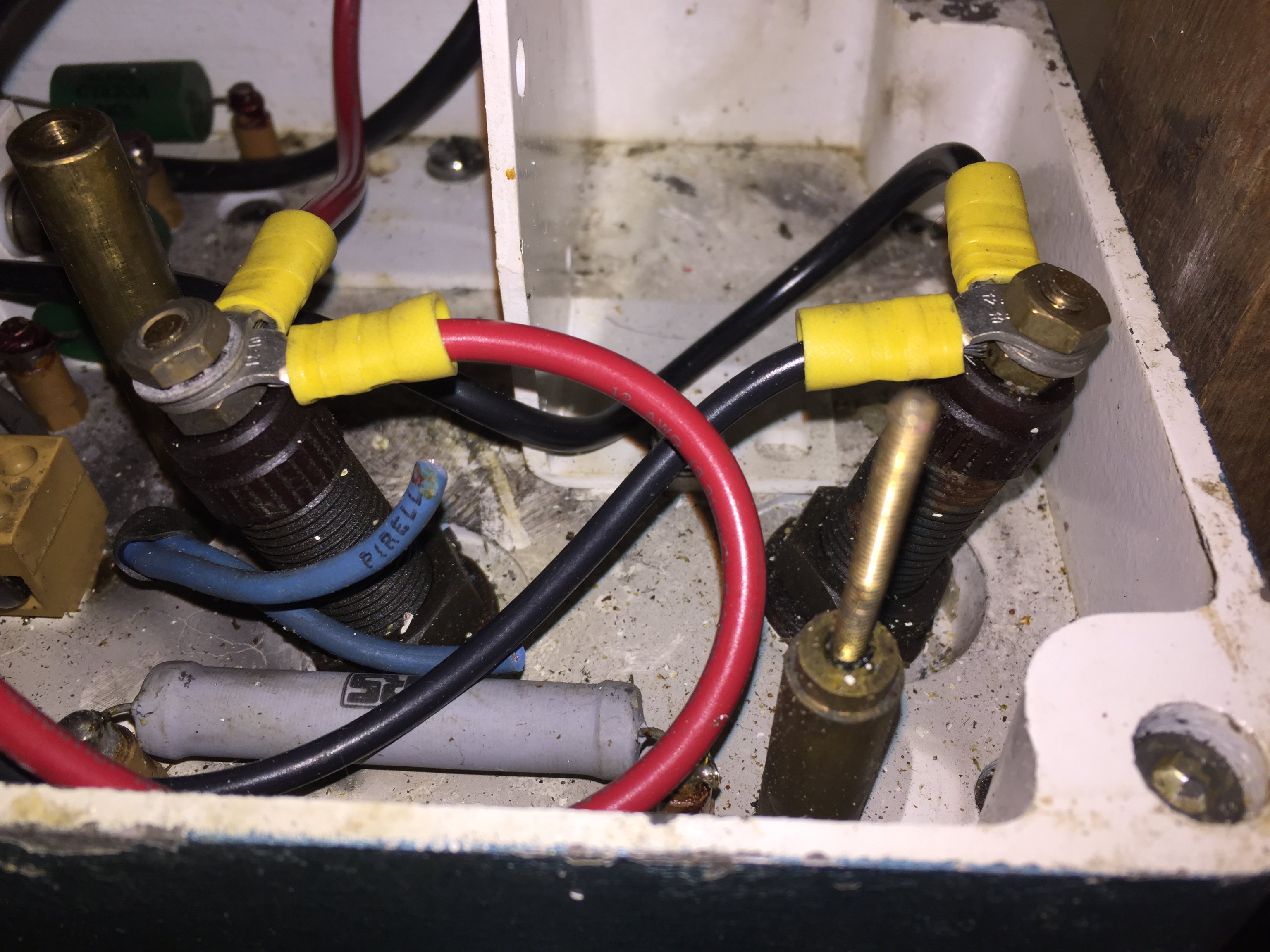

This is how my Neco Motor is wired to ray marine ACU 400.
I have the control head from NECO. Mine did work but needed to be set up with adjustments made in the motor. Send a PM to me if you are interested.
Inside of Motor post modification: -
Regarding the motor. It is old and while Hudson Marine tested it, I do not expect it to last any significant time. I would not trust it on a long voyage. Other forums have commented on reliability and failure of the motor under prolonged use after conversation. If changing for blue water use, long distance sailing, I would change out the Neco motor, in my case for a Jaffa rotary unit, as that would best suit my steering arrangement. However, for pottering about in a coastal environment, reliability is not such a big issue.
