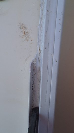

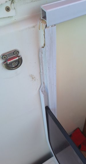

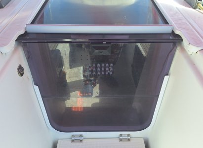

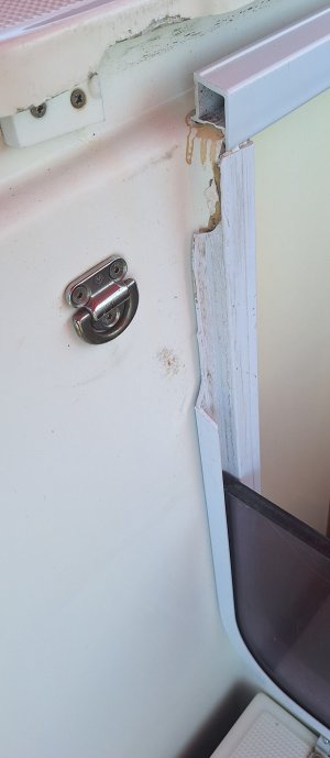

The companionway rail trim has been broken since I purchased the boat. Any suggestions on where to find a replacement? I have searched but have not found anything yet - possibly using the wrong search terms.

Trim both sides plastic to same .... cut back the 'wood' ready to replace
Then get two hardwood battens and create the L shaped by glue and pegs .... sand to required and then fix in place.
I've had to do this job on two boats ...
Trick is to alter the cosmetics so that repair appears same both sides and not as an afterthought.
