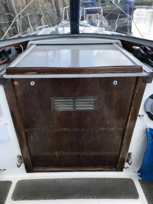

Hello all,
I’ve had a break in into my Griffon last week. I’ve got two washboards and a sliding acrylic top as in photo, with two 1/4 turn locks. Can anyone help with suggestions for more robust locks or any suggestions to increase security without making it too difficult for me to get in!

Your washboards are secured with what appears to be three screws in each of the panels either side. A crowbar will remove one of these panels in under a second with very little noise and the washboards will come out easily regardless of lock since there will no longer be a groove for them to slide out of.
The only way to improve security really is better location, but even at my marina which has CCTV on all pontoons, a tender was stolen this year by someone who arrived by boat. As others say, minimise damage and remove valuables or secure them within the boat.

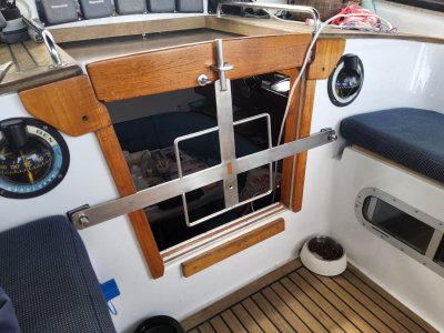

We work on the basis that we don't want anybody getting in through the main hatch. Our security at the main hatch is considerable. They won't get in via the main hatch without bolt cutters to cut off the paddlocks

When ours was broken into many years ago it was the chamfered washboards that were the weak link. Easy to get a tool between them and lever them apart. I made a one piece washboard for when we leave the boat and this is far more secure.
Ditto, but security bar on the outside as well.

Exactly. My security bar will stop the local yobs after they have had a drink but a determined thief will need bolt cutters. The yob won't even attempt my companionway. He will do the boat next door. Deck hatches are easily replaced so I would rather they broke the plastic handles on those

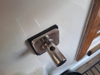

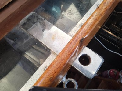

We also have a very secure companionway security bar. A thief won't get in unless he comes equipped with bolt cutters. At that point a determined thief was always going to get in anyway
Any chance of a picture, to see if I could make one?
