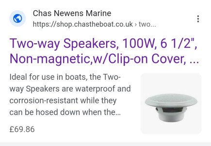

As said I really doubt that the "non magnetic " speakers have no magnet in them. The only alternative to magnetic speaker is piezo electric as sometimes usedd in ear buds. I have not heard of that in speakers. A typical speaker has a powerful magnet but the field is enclosed ina very tight circuit with only a gap of a millimeter or so. I would suspect that this is part of Non magnetic claim. So OP has had speakers mounted for a long time no problem. He should compare magnetic field with a hand compass of the old speakers with any new option. I think the "speaker safe compass distance quoted would be very conservative. ol'will
Normal speakers have pretty powerful magnets at the back, enough to firmly stick a screwdriver, and the occasional Stilson wrench on. I use the magnet from an old 12” guitar speaker stuck below a steel tray to keep nuts and bolts safe when working on my van engine.
Shielded speakers have enclosed magnets which reduces the magnetic field around them. They were very commonly used in tv surround sound systems and desktop computers in the days of cathode ray tubes when the magnets in unshielded speaker cabinets would cause rainbow effects on nearby screens.
