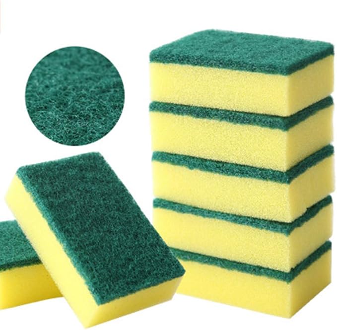

Not the same, but when the air filter on my VP2003 disintegrated, I made a new one from a tupperware bowl with suitable holes cut into it and a few of these
Green to the outside as a coarse filter, yellow to the inside as a fine filter. It looked the biz and worked fine - probably better than the original, especially once the original started feeding bit of rust to the engine :oops:
Am I the only one who wants to see a picture of the actual thing? haha.
I mean, when in a pinch, you could do loads of things to filter diesel. Sponges would have been the last thing I'd think of though.
Sorry, I've sold that boat now, so you'll have to use your imagination, but the container was black and vaguely conical air filter shaped, so it didn't look outrageous. The sponges worked as air filters because they're open cell foam and let the air through no problem, but I wouldn't use them for diesel, as I could well imagine them disintegrating and causing a total nightmare of blocked pumps and injectors.
