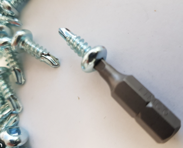

Some of mine with a Mikuni MY30 kept coming off at the outlet end so a couple of the self drilling screws worked a treat.
