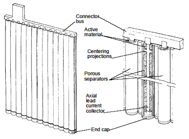

The best most long lived traction batteries have what are called tubular +ve plates. Instead of a pasted grid, there is a set of parallel spines surrounded by paste enclosed in polyester mesh tubes. They are big, heavy, expensive and mainly used in fork lift trucks.
