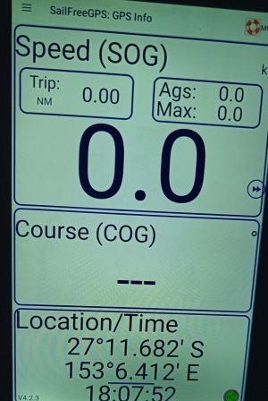

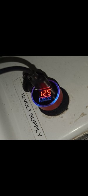

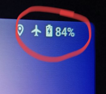

I have now purchased an 8" Lenovo Tab M8 which comes with a USB C connector. It runs fine off my usual 12 volt USB outlet exactly the same as the old Huawei used to.
Result! Indonesia here we come.
