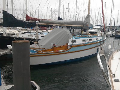

Not sure there is much risk of chafe in a stack pack except at the edges of the slots for reefing lines if you have them. I have had 3 stack packs made by Kemps none of which had any reinforcing in the body. The latest one is made of Sauleda as is the spray hood and cockpit cover. PVC, again in Sauleda as in post#2 across the aft end of the sprayhood and around the winches and aft corners as can be see in the photo. Good luck with making your own. There is a lot of work both in getting the design right and making it, but therefore big savings using your own labour. Best not to skimp on materials and thread.
