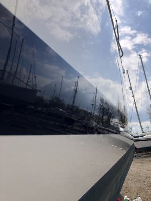

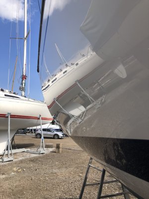

I have used it after very carefully cleaning and then cutting and polishing with Farecla Profile system to get to a high gloss finish (three different levels). I followed the advice of 'MarineReflections' who is an expert boat polisher and used to post on here.
I used Gtecniq "C1 Crystal Lacquer' and used their cloths and applicators (but you can use cheapo make up circular wipes) and was impressed at the time and almost a year later (when I sold her).
I will do it again with the current boat when I haul her out.E6DBE689-767E-42F6-9EBD-104D3778E471_1_105_c.jpeg96A67FC6-FBE5-4F0B-997E-456B2E96BB17_1_105_c.jpeg
I will do it again with the current boat when I haul her out.View attachment 155035View attachment 155036

I would have no hesitation in using it again and it is super easy to do, the hard bit is the prep depending on the state of the hull to begin with (no different to wax).

A couple of years ago, I used a number of Gtecniq products, including their polisher and the crystal laquer. I'd bought a boat with very faded red gelcoat, and as it was getting thin in places, I didn't fancy repolishing with the usual waxes on a regular basis.
Hence I did just one big cut and polish to get it back to dark red and then went with the Gtechniq stuff. It worked really well - looked amazing for the first year and pretty good for the second. After that, I only needed to do the lightest of polishes and then reapplied. Would definitely consider again if I didn't now have a painted white boat (which I kind of ignore now!)
