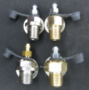

@DinghyMan you mean you machine banjo bolts with a seal for the hemispherical brake bleeder bit at the back? Got a pic of how this looks like as I'm confused tbh.
Banjo bolts in 316 with brass brake bleeder, and assorted size and thread variations on replacement bleed bolts, they come with some plastic pipe so you can bleed systems without having diesel going everywhere
M6 through to M16, fine and coarse threads
They have an O ring between the bleeder and the main body and come with spares, they also come with a dowty washer to replace the copper washer
Made in-house, as is everything we make, so can be supplied with metric or imperial threads
