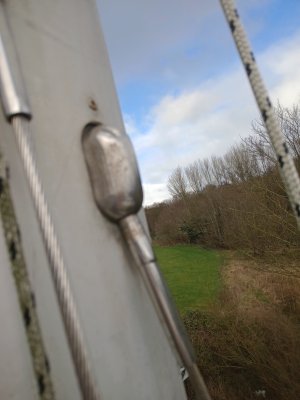

Hi all
In the yard at the moment replacing a shroud
I'mIMG_20240218_135036.jpg used to fittings that just hang in slots in the mast but this fitting disappears into a cover and I've no idea how to search the shroud
Hoping I don't have to drill out the rivet on the cover ?
BabaYaga
19 Dec 2008
2,490
Sweden
I believe the type of terminal is called stemball fitting. It goes into a backing shell. Sometimes a cup or washer is needed between the stemball terminal and the shell. Omission to fit these, when they are needed, is a common cause of rig failure with this type, I have heard.
