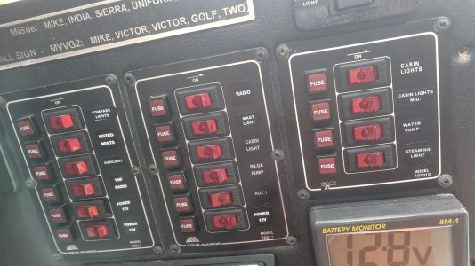

Hi does anyone know how an earth to remove fuses from this type of panel?
I have tried everything and they are completely locked in.

Hi small pin hole at the bottom of the fuse holder use a bent paper clip will release fuse holder it works for me.
Genius. That worked. All up and running again. It would have helped if i could see where it clearly says on the side of each fuse... "Open" 🥴😞😞
Thanks so much for this
