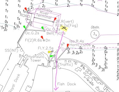

So, as the title suggests, we are not hearing some stations that are very close to the boat (causing issues)
(I am going to be very specific here) On approach to Grimsby (where the highlighted cross is on the chart, intending to follow the purple line) we were calling Fish Dock Island on Ch74, hearing other traffic do the same but not hearing any response (though he was able to hear us as we use a mobile phone to ring the lock office). We only just had enough water in the tide to get over the cill so the boat was about 5m down from the top of the sheet pilings but i hardly see that making much of a difference.
We have a fixed ray73 radio, fully set up with the MMSI number entered, squelch set to 3/10 and power set to 25w, we also have an icom handheld VHF which was fortunatly able to pick up the signal from the lock keeper. However, the following morning top side of the lock, we were able to hear the lock keeper on the Ray73 with no changes to settings
anyone had similar experience or a possible fix?.

we were low side of the lock with (roughly) 2m antenna on a beam about 2.5m above waterline, the tips were probably 2m bellow the concrete walls a good 150-200m away from the lock/walls
