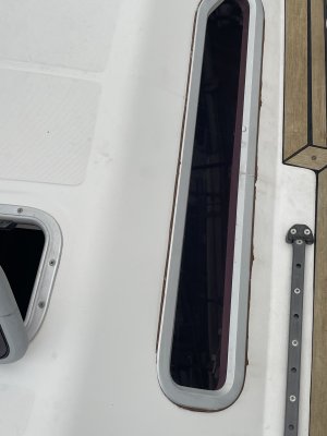

Hi
Recently sorted a leak in the cabin window by taking out the whole window and resealing with brown butyl tape. NO white available at the time.
The excess was squeezed out and I safely remove this using a sharp knife?

Do not use a metal blade as you will cut the gel coat. Use a sharp piece of plastic such as the type of spreader used for plastic padding. Keep a sharpish edge on it with a file or a sharp blade.
You will need to tighten the fastenings and re-trim the surplus in a few months time.
I used a Stanley blade years ago to trim round a fitting and even though gentle still see the blade marks.
The OP might get away with using a dinner knife but no real pressure on it.

I always use a bone handled dinner knife because they are easy to find although sometimes come with a telling off. It doesn't, in my experience, require significant force, so I wouldn't be concerned about the substrate unless using something sharp.
