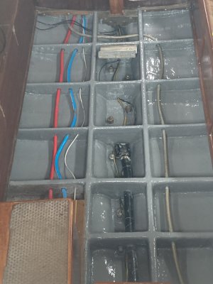

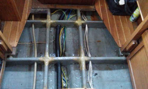

When I bought my Fulmar, the surveyor commented that the aft end of the keel rib was not strong enough on early models and had not been strengthened. He showed me using a straight edge how the keel was pressing the hull in by 10mm just aft of the keel whilst out of the water. It was a job he advised needed doing, but was not urgent as she was 33 years old at the time. This year, 9 years on, I finally reinforced the keel rib whilst in the water and am awaiting getting lifted in a couple of weeks time to check if the 3 layers of 300gsm mat and epoxy have strengthen the area affected sufficiently.
This was how the keel rib, looking aft, was like when I purchased Concerto. Notice the poor corner laminations that the previous owner added that did not add any real support.
This is the completed job after being Danboline painted, looking forward. Where the step box is resting you can just see some of the reinforcing that had not been painted. None of the reinforcing was taken over the top of the ribs as this would have raised the floor. The reinforcing stopped in the section by the bilge pump strum box and went back to just behind the start of the engine bearers. If you look closely you can see the forwaed ribs over plywood are thinner than the aft ribs, but I also covered all the flat areas within the ribs.

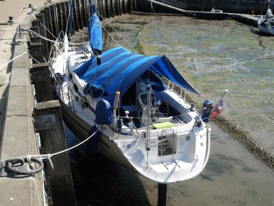

My current boat stayed in the water for ten years before I lifted her out. All she needed was pressure washing while safely leaning against a wall between tides.
My first monohull (other than an MFV work boat) spent at least one winter, mast down, on a pair of beaching legs. That was a Trintella 29. Again the same hull type.
