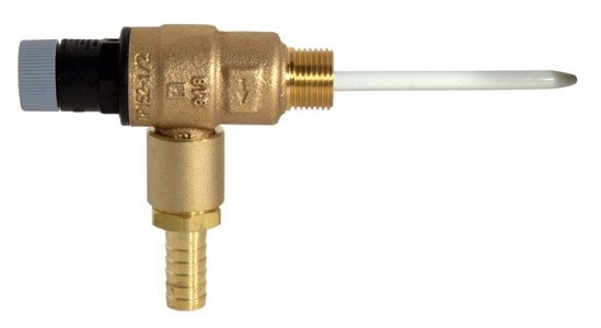

Mine is similar to this:
The left hand side of it, in this pic, beyond the drain pipe, is hidden under a sort of shelf in my installation, so i can't get a good look at it. The knob on top seems to rotate. More than that I do not know.
The knob has something akin to a cam on the end of it, which forces the valve open. If it needs changing, you change the whole thing. No need for an expensive "marine" one, you should be able to match one at a plumbers merchant/Screwfix etc

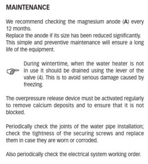

This calorifier produces hot water from the Incoloy electric heating element. Also featuring a safety / non-return valve that allows discharging of the water heater in case of disuse, set at 6 bar (±1). (Taken from Quick Calorifier 22 litre manual). So it might actually be doing it on purpose because the boat has been idle for some time.
