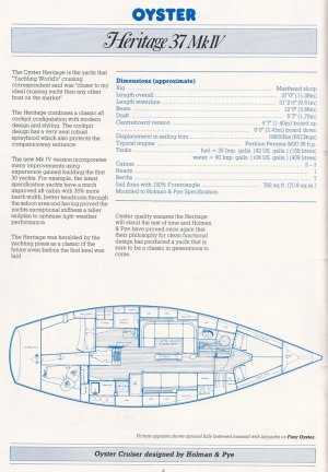

Here is a copy of a catalogue that I have for the Heritage 37.
Oyster Heritage 37 P 1.jpgOyster Heritage 37 P 2.jpgOyster Heritage 37 review.jpg

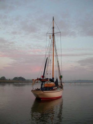

It was not the boat’s fault; it was entirely mine.
Filled the tiny self draining footwell, but she doesn’t have washboards- you step up and over the aft coachroof coaming. About a pint got past the closed companion hatch.
I was clipped on on a short tether and I got religious about that!

I got pooped in this, once.View attachment 169371
Well that certainly fulfils the “row away factor” criteria! What is she?
