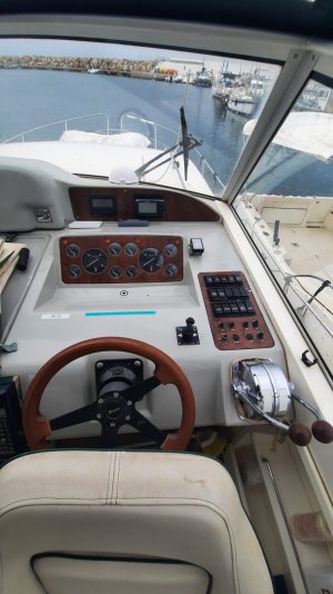

I've made quite a few replacement panels. Often with the manufacturer's logo or the name of the boat. All I need is a pencil drawing, I can do the rest.
Normally on black panels but white and metallic finishes are also available.
I'm also happy to supply the switches.
Here's a very simple one that I designed and made for a Sunfury. Owner was chuffed to bits.

Those dash panels certainly leave mine in the shade. Did you get it cut from the black on white acrylic for sign writing? I did enquire about that but they only had very thin sheet acrylic in black on white.
I spoke to my Graphic Designer sister yesterday and she said the lettering can be done on a Cricut machine in vinyl. Her friend has a machine so I’ll see I can barter some wine for stickers.

Traffolyte engraving is what you want - it's a two or three layer material where the top surface is engraved exposing the contrasting colour below.

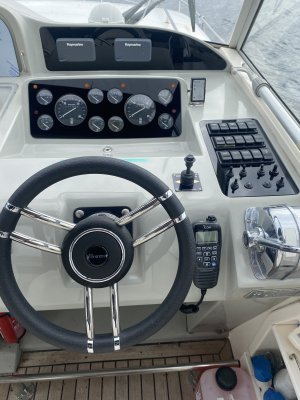

The work continues. Full dashboard refurb, new i40 speed to match the i40 depth. New wheel from Osculati. It came with a compass rose in the centre so I got my graphic designer sister to digitise the Broom logo into a vector and got www.wheelbadges.com to make me a new 40mm centre badge.
New Icom 440BB vhf fitted.
I also started polishing the dashboard area with my new Proxxon detail rotary polisher. Very hand bit of kit.

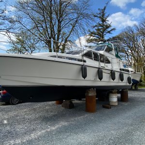

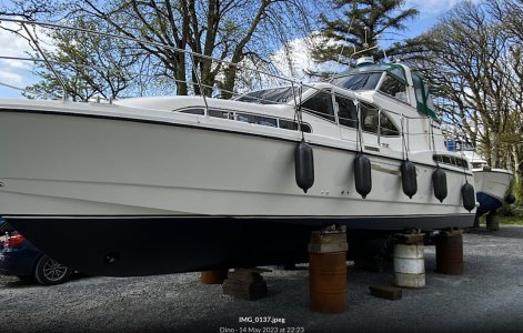

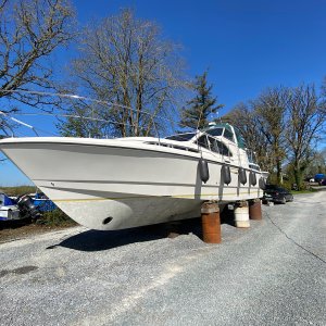

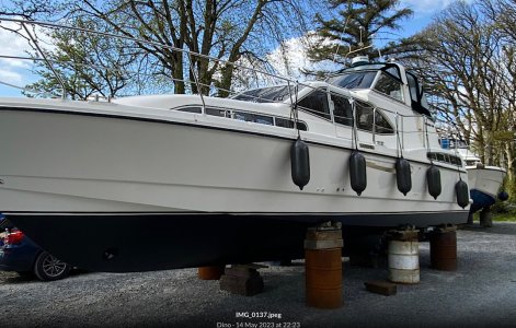

I also had the boat out of the water for a few weeks to do the bottom.
I got it blasted with glass beads
Then primed with Primocon and two coats of antifouling

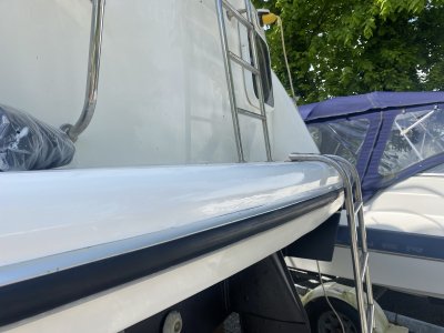

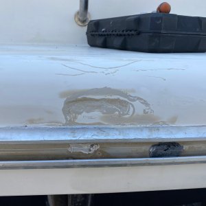

Then I had a really ugly looking badly repaired section of gelcoat across the aft lip of the bathing platform

Nice work Dino. The black really lifts the dash. It’s hard to tell in the photos but I suspect the gauges might be faded/ hazy. it could be worth trying some of the headlight restoration wipes you see these days. 3m, Armor All etc. have various offerings.

The dials were a bit scratched and hazy so I gave them a quick polish with the new detail polisher with the 2 inch pad. I probably need to go over them a few times to get them shining.
